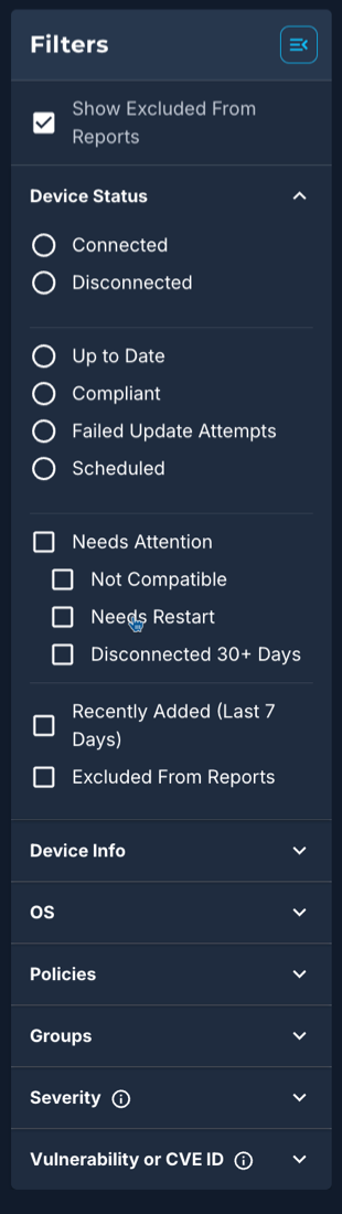

Device Filter Panel
The filter panel is made up of various options to fine-tune your search. When you select any of the individual filters, a number in parentheses shows how many are selected. You can clear selections individually, or select Clear All. The panel can also be collapsed. These settings are saved in the URL. When you navigate to other pages and return to the page, your settings are maintained.
By default, this list shows all devices, including devices that are excluded from reporting. To hide these devices, uncheck the Show Excluded From ReportsClosed Exportable data (PDF, CSV) for device management analysis.. See Device Details for information about excluding devices from reporting.
Device Status
To filter the list of devices by device statusClosed The current state of the device: Connected, Disconnected, Pending Restart, Failed Update, etc., select from the following options available from the device filter panel. The resulting list of devices updates immediately when an option is selected.
You can select from Connected or Disconnected, which are mutually exclusive options:
Status
Description
Connected
View only devices that are online and connected. You can view the current status and take actions on these devices.
Disconnected
View only devices that are not connected. It is not possible to take any patching actions until these devices are connected again.
You can select from Up To Date, Failed Update Attempts, or Scheduled, which are mutually exclusive options:
Status
Description
Up To Date
View all devices with no other updates for the device. These are fully compliant, do not need attention, and have no other pending status conditions.
Compliant
View all devices that are up-to-date based on their policy and schedule.
View all devices that failed to successfully install new patches. Manual intervention might be required.
Scheduled
View all devices that are awaiting a planned update (as per the policy details).
You can also select Needs Attention, or one or more of the Needs Attention subcategories (Not Compatible, Needs Restart, Disconnected for 30+ Days). This provides a more granular way to see which devices need attention, and for what reason.
Status
Description
Needs Attention
View all devices that have failed to patch for any reason. These devices might need manual intervention.
Not Compatible
Use this to filter devices that do not pass the compatibility check. See the Troubleshooting section in Device Details for more information.
Needs Restart
Use this to filter devices that need to be restarted.
Use this to filter devices that have been disconnected for 30 or more days.
The filter logic has been improved, and will now show devices that meet one or more of the selected criteria, so you can get more clarity on the status of your devices.
The following filter statuses can also be selected, to specify Recently Added (Last 7 Days), or devices that are Excluded from Reports:
Status
Description
View a list of all devices that were added within the last seven days.
View all devices that have been identified as "special" or to be excluded from reports (formerly "exception"). These can, for example, be devices used for testing or are legacy devices. These devices are not included in the reporting and metrics but continue to be managed.

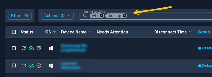

Enhanced Device Search
You can quickly narrow down data from the filtered search by using the search bar at the top of the Devices page. This enhanced search allows multiple queries and partial matching.
This search will not show results outside of data results acquired from the device filter panel.
This searches across multiple fields:
  • OS
  • Device Name
  • Group
  • Tags
  • IP address (public and private IP address search)
  • OS Version
When you enter search criteria in the search bar, each entry is shown in the search bar. To remove a query, click x. You can add as many search items as you want. The results will include any matching data and will not exclude other matches.

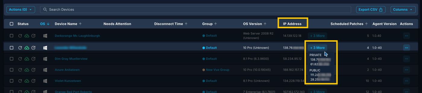

IP Address Search
From the Devices page, you can search for both public and private IP addresses. Multiple devices can be associated with the same public IP address.
Note: You may notice a discrepancy in the Private IP address shown on the Devices page compared to the Device Details view. The Devices table currently displays legacy data, while the Device Details page uses newer inventory data. This can result in different IP addresses being shown for the same device. We are actively working to transition the Devices page to use the same inventory-based architecture, which will eliminate these inconsistencies.
  • To view all associated IP addresses for a device, hover over the listed entry in the IP address column.
