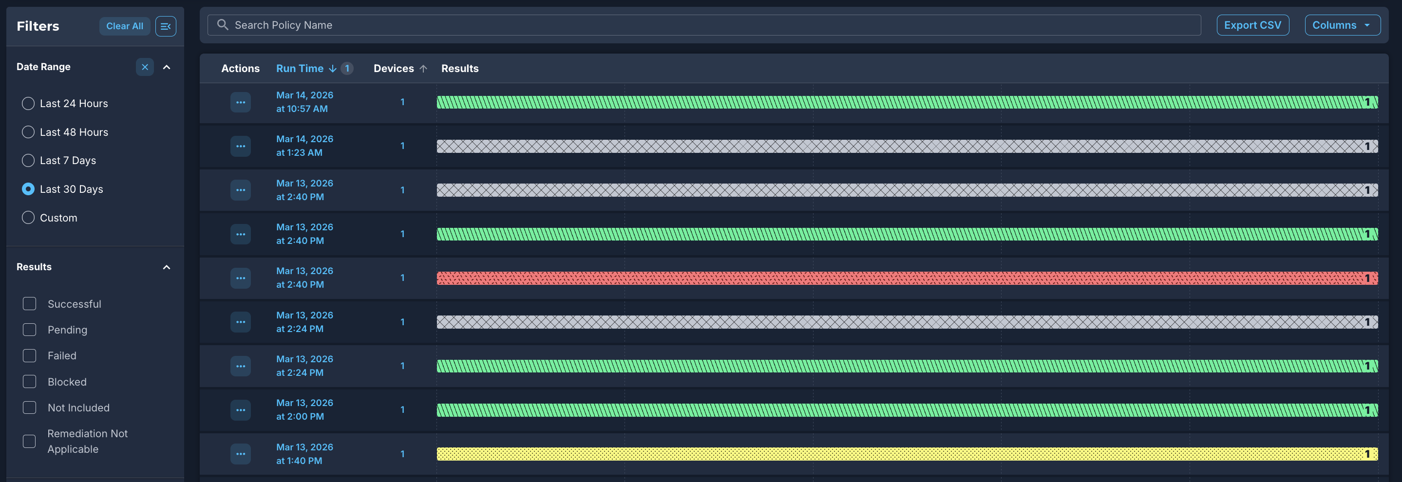

Policy Results Report Table
From the Reports page, click View for the Policy Results Report. The following information is available from this table.
Column
Description
Actions
Possible options:
  • Run Policy
  • View Policy
  • View Device Table
  • View Policy History
Run Time
This shows the date and time of when the last run was started for this policy.
Click this timestamp to open the Device Table.
Devices
This lists the number of devices that were associated with the policy during the run.
Policy Name
Click the policy name to open the Policy Run History.
The current name of the policy is shown with historical information for that policy even if the policy has been renamed. If a policy is deleted, that will be indicated. The most current name of that policy is used.
Results
This visualization provides at a glance results for this policy. Hover over the bar to view details.

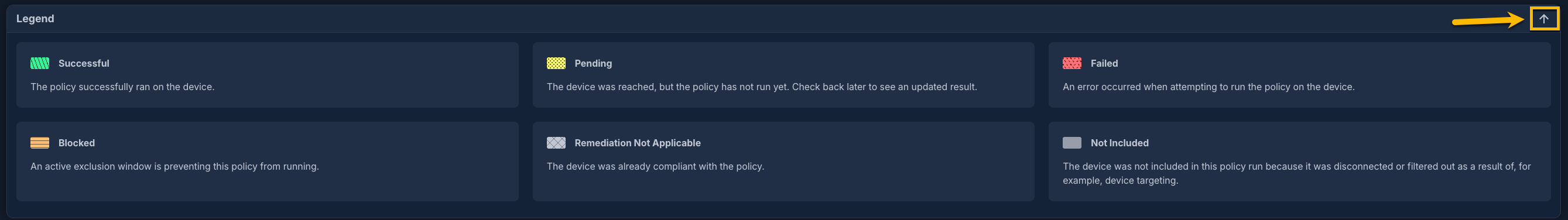

Status tiles: Legend
You can identify the status of the most recent policy runs by reviewing the status tiles. Use these as a reference for the filters and report details. This legend is hidden by default. Click the arrow to show or hide the details.
Status tile name
Description
Successful
The policy successfully ran on the device.
Pending
The device was reached, but the policy has not run yet. Check back later to see an updated result.
Failed
An error occurred when attempting to run the policy on the device.
You can view the reason for the failure within the report.
Blocked The device was in an active exclusion window when the policy was scheduled.
Remediation Not Applicable
The device was evaluated and no action is required.
The device was already up to date with the policy. Specifically, the device was scanned and no remediation is necessary.
Not Included
The device was not included in this policy run because it was disconnected or filtered out as a result of, for example, device targeting.
Filtering and Searching in the Policy Results Report
The filter panel is made up of different types of options to fine-tune your report. You can filter the list of policy runs by date range, results, policies, and display options. When you select any of the individual filters, the table automatically updates. You can clear selections individually or select Clear All.
You can hide or show the filter panel, as needed. The filter panel shows by default.
Date Range
You can filter the list of policy result runs by date.
Open the Date Range menu and select from the options:
  • Last 24 Hours
  • Last 48 Hours
  • Last 7 Days
  • Last 30 Days
  • Custom: Use the calendar options to create a custom search. For details, see Using the custom date calendar.

Status Results filter
You can filter the policy results report by the status results. You can select multiple policy status results to filter the list by. The corresponding view is updated immediately.
  • Successful
  • Pending
  • Failed
  • Blocked
  • Remediation Not Applicable
  • Not Included

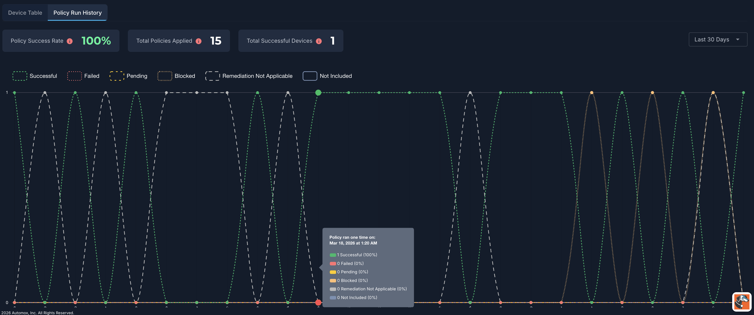

Policy Run History
You can view history for a specific policy run. There are two ways to open the Policy Run History page from the main policy results report.
  • For a specific policy select Actions → View Policy History.
  • For a specific policy, go to the Policy Name column and click the name.
The Policy Run History page opens.
The event results are shown graphically.
This page provides a visual representation of the Device Table event data that you can drill into for specific dates. Use the drop-down menu to adjust the number of days presented.
