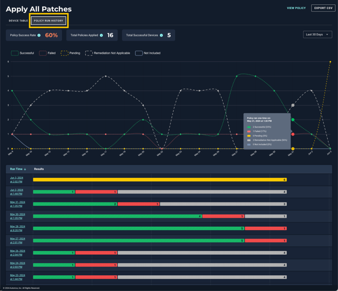

Policy Run History
You can view history for a specific policy run. You can open the Policy Run History page from the main policy results report in two ways.
  • For a specific policy select Actions → View Policy History.
  • For a specific policy, go to the Policy Name column and click the name.
The Policy Run History page opens.
The report shows the event results graphically.
This page provides a visual representation of the Device Table event data that you can drill into for specific dates. Use the drop-down menu to adjust the number of days presented.
