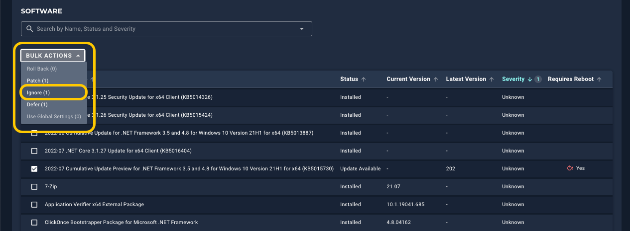

On the Device Details page, the list of software and patches are shown at the bottom of the page:
- Select the checkbox for the software you want to block.
- Select Ignore from the Bulk Actions drop-down menu.
- Confirm the selection.

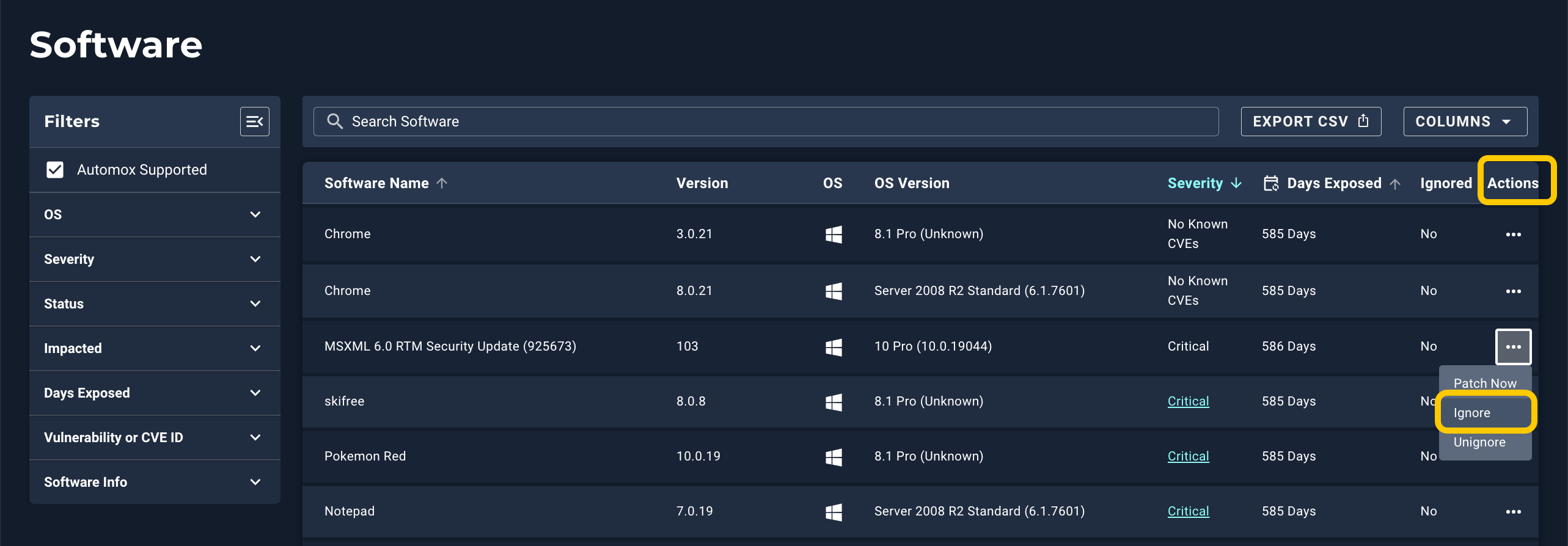

On the Software page, the Actions drop-down menu can also be used to ignore the patch.
- Select Ignore from the Actions menu. Note: There is no confirmation message and is effective immediately.
