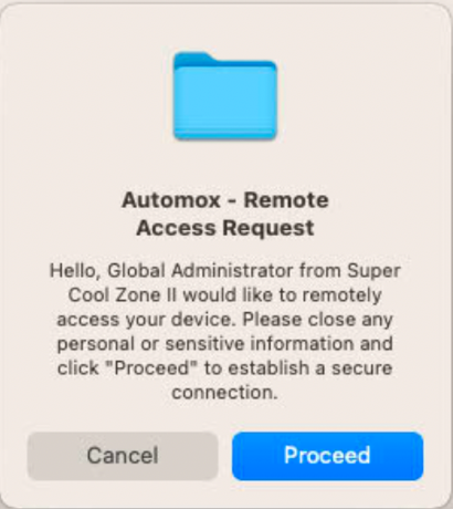

Configuring Consent Notification
By default, all devices require consent by the remote user before a remote session can be established. This requirement can be configured by global and organization administrators, as described later in this section.
A consent notification allows remote users the option to accept or deny a remote connection with the administrator.
- If the remote user clicks Proceed, the remote control module establishes a secure connection between the remote and admin devices.
- If the remote user clicks Cancel, the remote control module stops trying to establish a connection between the remote and admin devices.
- By default, consent is required to remotely connect to any device.
