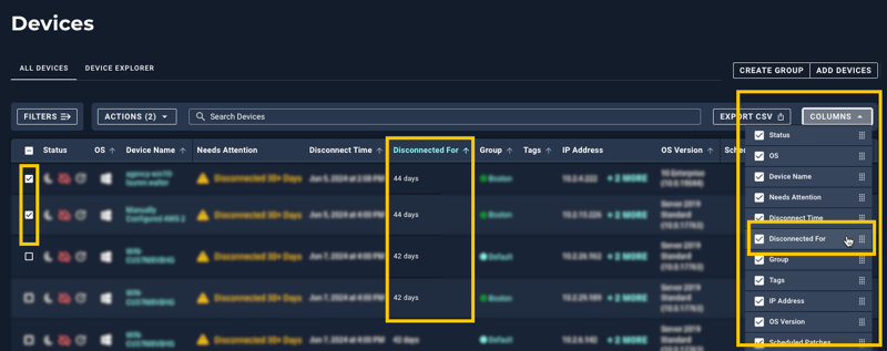

Disconnected Devices Cleanup Using the Automox Console
Follow these steps to clean up disconnected devices using the console.
  1. Go to Devices in the console.
  2. Select Columns.
  3. Select the Disconnected For option in the Columns drop-down menu.
  4. Sort by Disconnected For to get a list of devices based on how many days they have been disconnected.
  5. Select the checkbox for all the devices greater than X amount of days. In the example, we selected anything disconnected longer than 44 days.
  6. Click the Actions drop-down menu and select Remove.
  7. All devices disconnected for more than X days are immediately removed from the console with this action.
