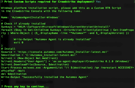

Print Scripts
- When selecting print, the script for each platform is printed for copying and pasting into the CrowdStrike console under Response Scripts & Files. The names of the scripts need to make those provided by the deployer.
 - Navigate to Response Scripts & Files and click Create a script.
 - Enter the name and description and ensure the correct shell type is selected for each OS. Be aware that Real Time Responder roles are required for this action. These can be added via User Management in the CrowdStrike console.
Repeat the steps for macOS and Linux by pressing any key twice and using the name and script content printed for each.
