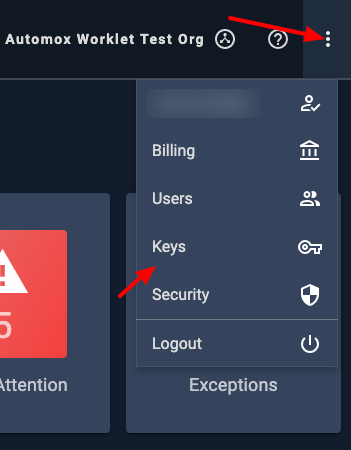

In your Automox console, click the kebab menu (the 3 vertical dots at the upper right), and then Secrets & Keys:

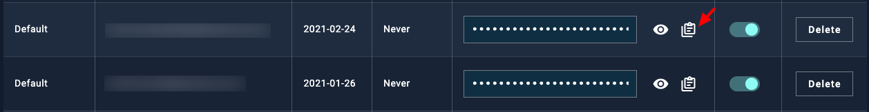

Select your API key (the one on the bottom). There's a handy copy icon to the right of the API key to get it into your clipboard.

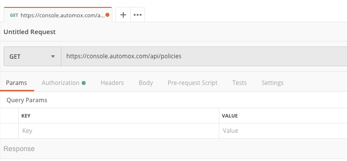

Open up Postman and click the New button in the upper left, then Request. From there, paste the following command into the Get window:
https://console.automox.com/api/policies
Postman-GET

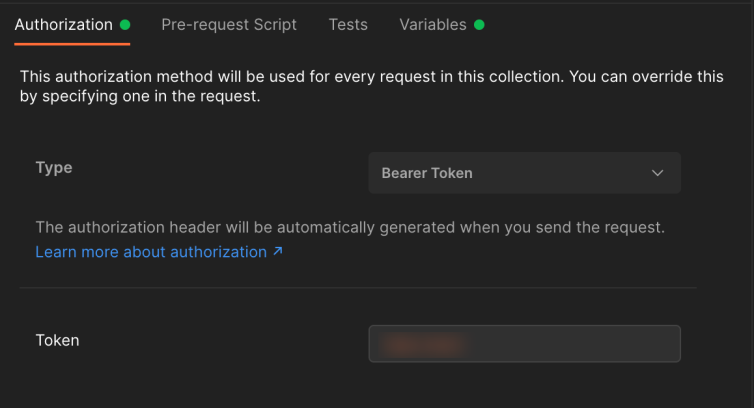

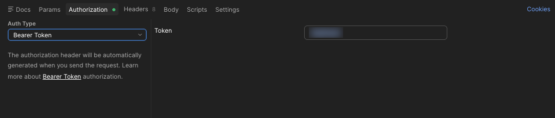

Grab the API key from Step 2, click on the Authorization tab, and select type Bearer Token in the drop-down menu. Then paste your API key in the Token field:
Postman-Token
It's best to use environment variables in Postman to store sensitive information, like your API keys. This will help later if you share your collection with teammates. Please see this article Managing Environments in Postman.

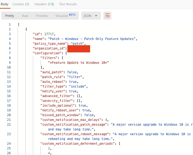

Click Send and then you should see a bunch of code appear in the Body section below the Query Params:
Postman-Response
This is all the data you would see if you drilled down into a policy on the console, plus some extra stuff such as internal ID numbers for the policies (PolicyID). But in this case you have all the data from all the policies in a handy JSON format that you can then do additional filtering and sorting on.

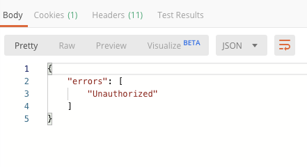

If you get any sort of error code, double-check to make sure you copied your OrgID and API Key correctly. If they don't match up, the API won't return any data because it doesn't recognize you as authorized to do so:
Postman-Unauthorized

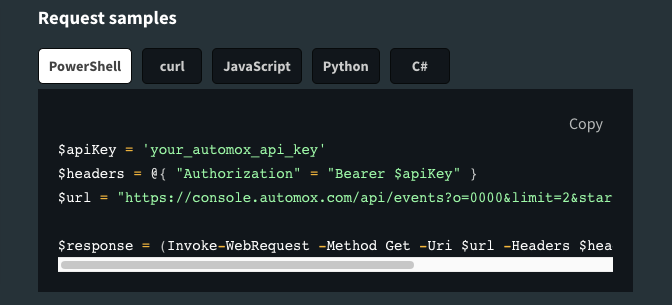

Now that you're no longer an API newbie, you can put your API call into a script and start working with your data. Each of the API calls has example code in various languages to the right of the Automox API Reference:
Request-Examples
